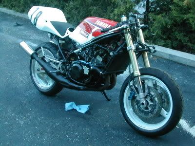

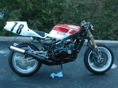

Atención con esta maquinita de abajo...Chasis y Basculante de Tzr 125 y motor de rd modificado a 480cc...
Mota 125 crank HP @9600 RPM ( will be tuned until i have 100 out of the gearbox )
Total dry ... 103 kg
bRUTAL...image image

    Por cierto te dejo por aquí los datos técnicos y el link de la tzr-rd...
    Specs ( actual set up ) :
    Frame 125 TZR R belgarda , stock wheel , stock forks , stock braking system
    Emc rear shock
    engine : based on a banshee LA sleeve kit heavily modified
    pistons 750H2 in 72.5 bore modified for read intake
    Sleeve Big bore 72.5 nickasiled
    cases 350 RDLC 31k/1wt modified to get the 72.5 inner sleeve
    Valves rotax Rave
    Crank 58 stroke 115 mm rods
    Ignition Borut's Zeeltronic Digital CDI
    compression 14.5/1 => Avgas
    removable plug domes
    Clutch :
    straight cut primary gears
    lock-up clutch
    8 discs set up ( stock machined )
    Intake :
    reeds 250 CR
    carbs TMS 38 without any jets ( kit HRC cross US ) - 4 different throttle valves , 26 needles avaible ( i ll scratch my head for the jetting )
    Exhaust :
    Home made ss 8/10e mm , Big fat thing ( a pain to fit under the bike ) , Tz end cans
    Instruments :
    digital EGT-CHT
    Coming next DATA LOG
    https://www.yamaha-rd.com/forum/topic-30926.html
